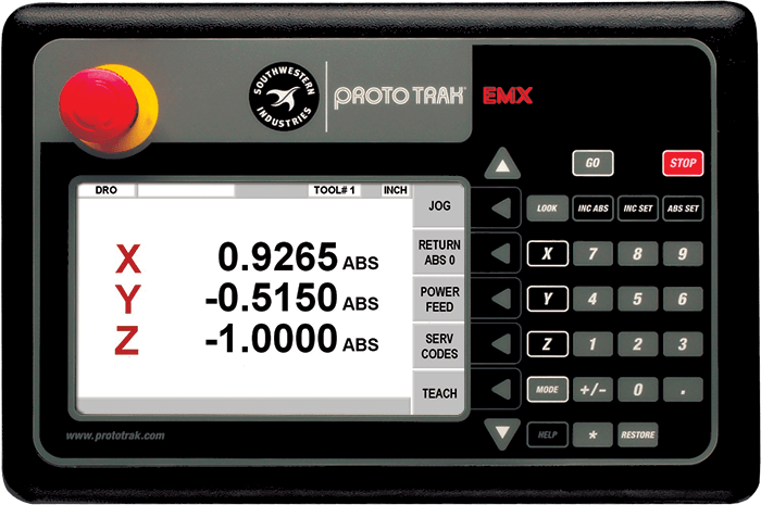

Download ProtoTRAK EMX/ELX CNC software here
emx_305_306.zip 845 KB
Changes from the previously released version
- Fixed an intermittent issue on the 2 axis EMX where if the user pressed the MODE button while in RUN mode, the axis may jump slightly.
Extracting the software onto your USB Thumbdrive
For Windows XP and later users:
1. Double Click on the zip file that you've just downloaded.
2. Go up to the top left hand corner of your window, and click on FILE, and then EXTRACT ALL.
3. An Extraction Wizard window will appear. Click on NEXT.
4. Underneath where it says "Files will be extracted to this directory:" choose the target path for your USB thumbdrive (for example if the thumbdrive is recognized as drive E on your computer, the path will be “E:\”). The files MUST be extracted within the root directory of the thumbdrive, and not within an existing folder.
5. Click on the NEXT button. This should start copying all the necessary files to the target drive. Once complete, click on the FINISH button.
Installing onto your ProtoTRAK control
Once all files are copied, take the USB thumbdrive over to your Prototrak EMX control and insert it into a free USB slot. From there, go into the DRO section, SERV CODES, and press 316 and then the ABS SET button. This will automatically update the software to the control, and ask you to recycle the power once complete.
