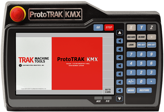

Instructions
  1. Download the kmx_x.x.x.zip file to your computer.
  2. Unzip the PT11-SETUP folder, and all its contents, directly to your USB flash drive.
  3. Take your USB flash drive and plug it into the KMX pendant.
  4. On the Pendant, press MODE -> SETUP -> SERV CODES -> 316 -> ABS SET, and then press the RESUME soft key to update the software.
