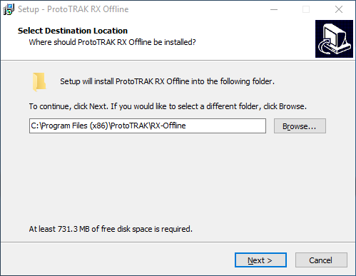

  3. If this is your first time installing the software, then you should be prompted for where you would like to install the software.
    (See Image: Select Destination Location)
ProtoTRAK RX CNC Offline Software Instructions - Select Destination Location

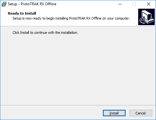

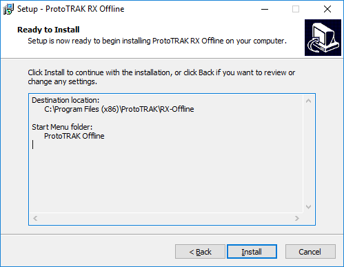

  1. Click on the Install button to begin installing the ProtoTRAK offline software.
    (See Image: Ready to Install - First Time Installation)
ProtoTRAK RX CNC Offline Software Instructions - Ready to Install - First Time Installation

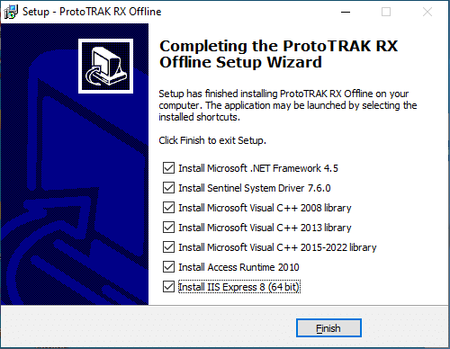

  1. Once the ProtoTRAK software has finished copying over, you’ll see this screen. This lists all the necessary components needed to run our software. If this is your first time installing, then make sure all of the boxes are checked, and then click on Finish. No harm should come if you already have something installed. Note that the installer will automatically detect if you need 32 bit or 64 bit files.
    (See Image: Setup Wizard - Check All Boxes)
    After you click Finish, you should see a progress bar show you the status of each individual program installing. Note that if you are prompted to restart the computer, you can choose to restart later so that you can finish installing everything that is necessary.
ProtoTRAK RX CNC Offline Software Instructions - Setup Wizard - Check All Boxes

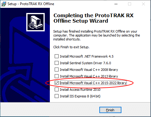

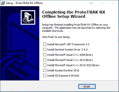

  1. When you get to the last window with the check boxes, you can simply leave all of the boxes unchecked, and then click on Finish.
    (See Image: Setup Wizard - Unchecked Boxes)
    However, if you are updating from a version older than 2.5.4, then you will need to enable the check mark next to “Install Microsoft Visual C++ 2015-2022 library”. This is to ensure that the software has all the necessary files needed for newer features to work properly. Click on Finish to install this update.
    (See Image: Setup Wizard - 2015-2022 Library Checked)
ProtoTRAK RX CNC Offline Software Instructions - Setup Wizard - Unchecked Boxes
ProtoTRAK RX CNC Offline Software Instructions - Setup Wizard - 2015-2022 Library Checked
