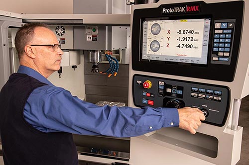

Its dual personalities, of course. You'd expect a machining center to work as a production machine, and this one does. In Production Ops, it's a full featured, 3-axis mill with a 16-tool carousel—perfect for low volume production. When you flip the switch over to Toolroom Ops, it does something unique.
Toolroom Ops lets you operate the machine like a TRAK DPM. You can use it manually with DRO, and 2 or 3 axis CNC. Plus, your chips and coolant are contained. You get the flexibility of a bed mill, the power of the ProtoTRAK, and no mess on the floor!

The ProtoTRAK RMX — the most technologically advanced ProtoTRAK ever — is at the heart of each machining center.
The touchscreen is the most obvious feature of the RMX. It's the key to a more efficient user interface, and the many features within the control. Here are some of the biggest:
  • Ability to do manual machining
  • Powerful solid model graphics
  • Enhanced ProtoTRAK Assistance
  • Defaults and User Profiles
  • Auto Geometry Engine®
  • Prompted programming events
  • Electronic handwheels and TRAKing®
  • Synchronized Program, Library and Carousel tools
