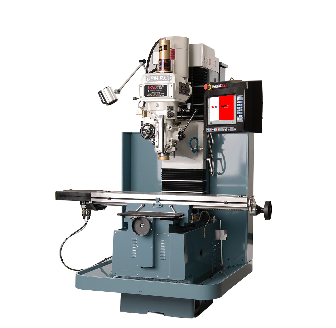

Fresadora de Bancada TRAK DPM RX3 Nuestra fresadora de bancada más popular: precio bajo + excelentes especificaciones
Especificaciones de la Fresadora de Bancada TRAK DPM RX3
  • Tamaño de la Mesa: 1,270 mm (50") x 254 mm (10")
  • Desplazamiento: 800.10 mm (31.5") x 431.80 mm (17") x 655.57 mm (25.81")
  • Motor del Husillo: 5 HP de Trabajo Continuo
  • Conicidad del Portaherramientas: Cono 40
Características Principales del Fresadora de Bancada TRAK DPM RX3
  • ProtoTRAK RMX CNC integrated into the machine at the factory
  • Solid ram moves along the column providing mass for heavy cuts
  • Generous Z-axis CNC travel
  • Strong and rigid
  • Efficient for any job: manual, 2-axis CNC or 3-axis CNC
  • Standard electronic head for programmable spindle speeds and tapping
  • Precision ground ballscrews installed in the table, saddle and column
  • Manual quill with integrated quill and ram encoders
  • Wide way surfaces are hardened and ground, slideways are Turcite® coated
  • Real handwheels so you can work manually
