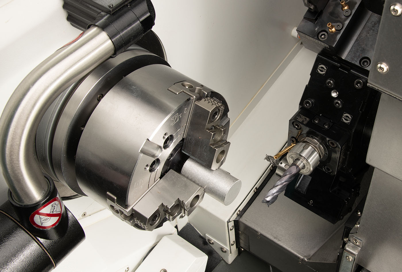

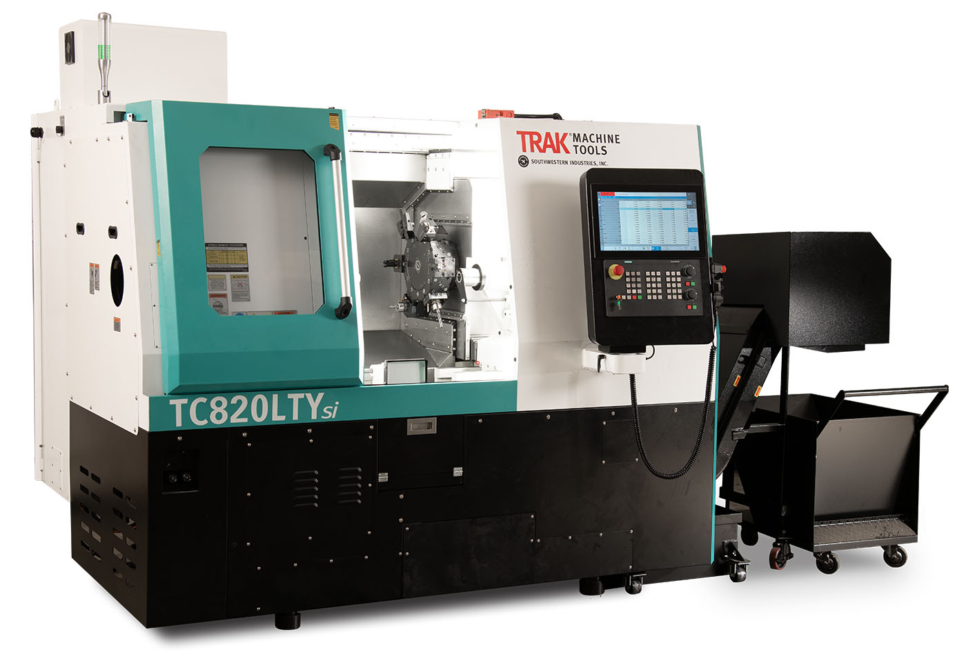

TRAK TC820LTYsi Turning Center featuring the SINUMERIK ONE CNC
Specifications for the TRAK TC820LTYsi Turning Center
  • Height of Centers: 47.3″
  • Maximum Turned Length: 19.29″
  • Number of Tools: 12 Live Tool Stations (BMT45)
Key Features of the TRAK TC820LTYsi Turning Center
  • Siemens SINUMERIK ONE CNC
  • 12 Station BMT45 Live Tooling Turret (4,500 RPM) 1/2 Index Expandable to 24 Tools
  • Coolant Through Turret

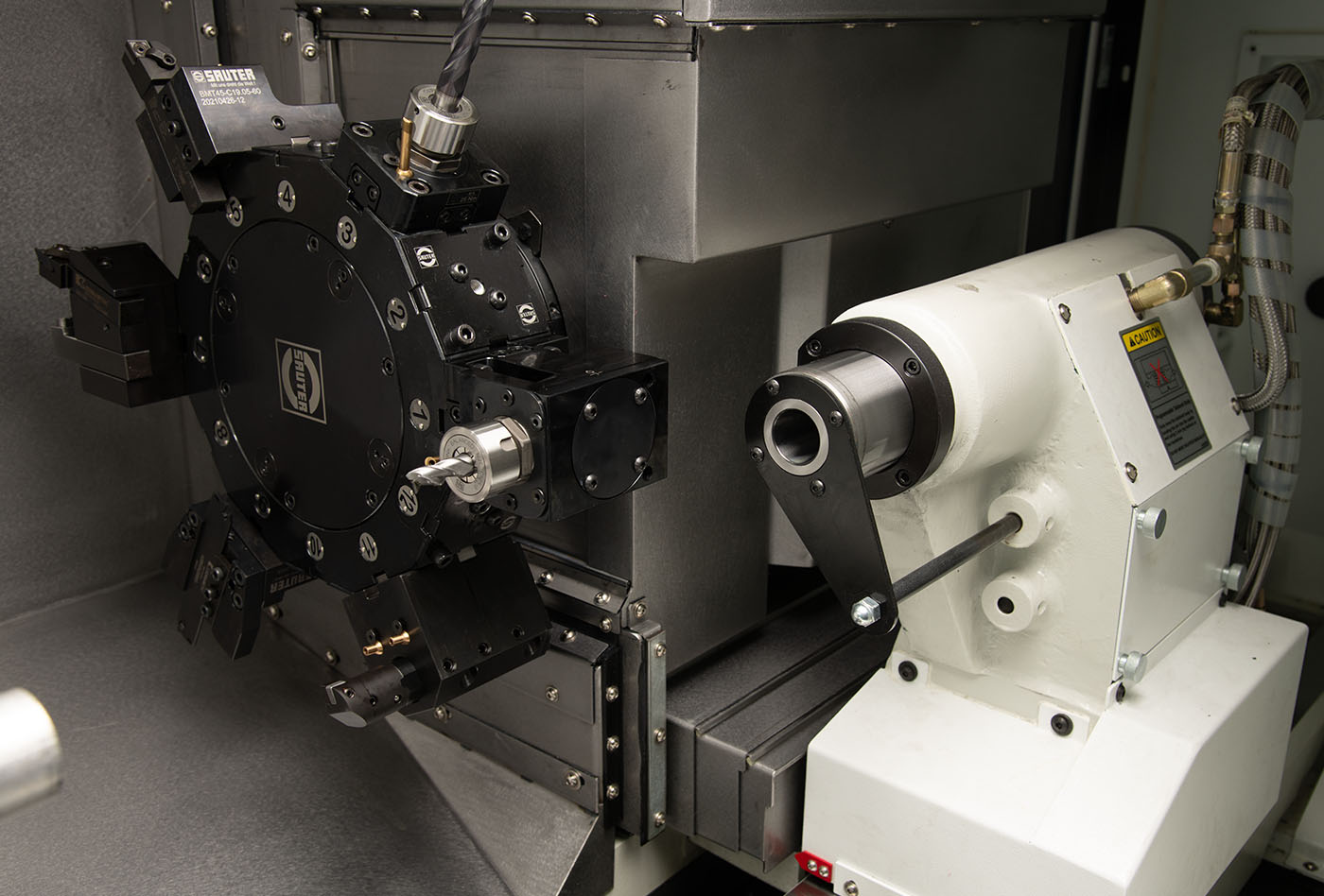

  • Hydraulically Clamping Programmable Tailstock & Quill
  • 4,000 RPM Spindle with 2.56″ Capacity
  • Hydraulic 3-Jaw Chuck
  • Automatic Tool Setting Arm & Probe
  • Hardened Box Ways
  • Direct Drive on X, Y and Z Axes
  • Precision Ground Ballscrews
  • Solid 8,000 lb Casting

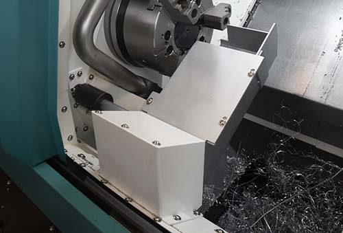

  • Chip Conveyor

Tailstock
Quill Travel 4.13″ 4.72″
Quill Diameter 2.36″ 2.95″
Quill Taper Hole MT4 MT4
Maximum Quill Thrust 691 lbf 1,233 lbf

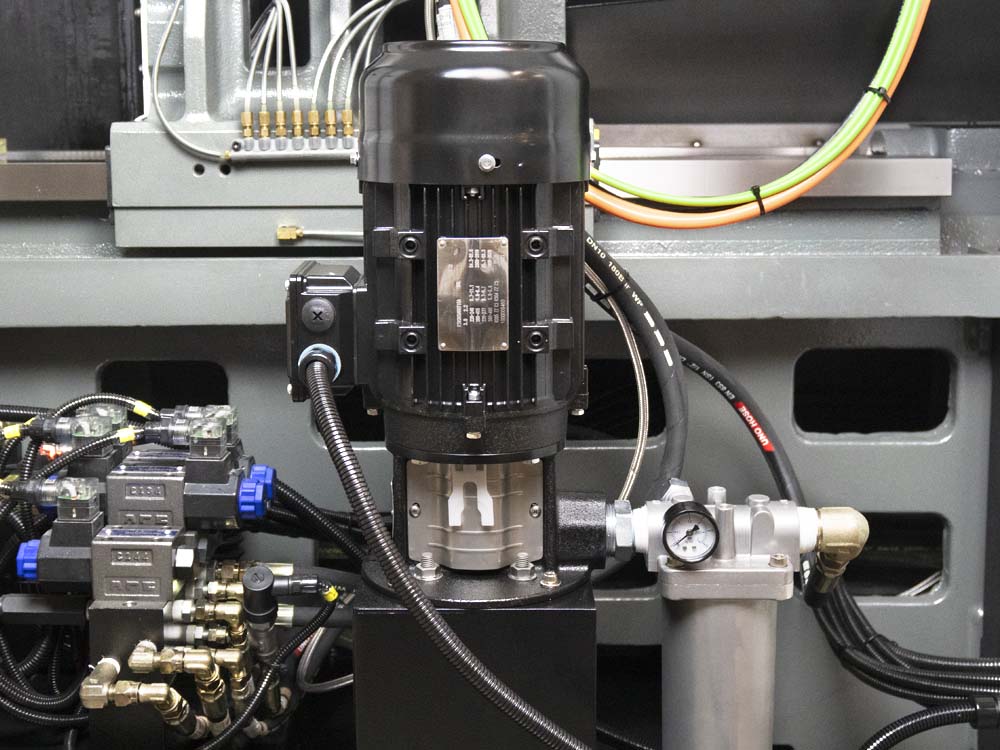

Hydraulic Oil Capacity 11 gal 11 gal
Hydraulic Pump Type Combination pump vane Combination pump vane

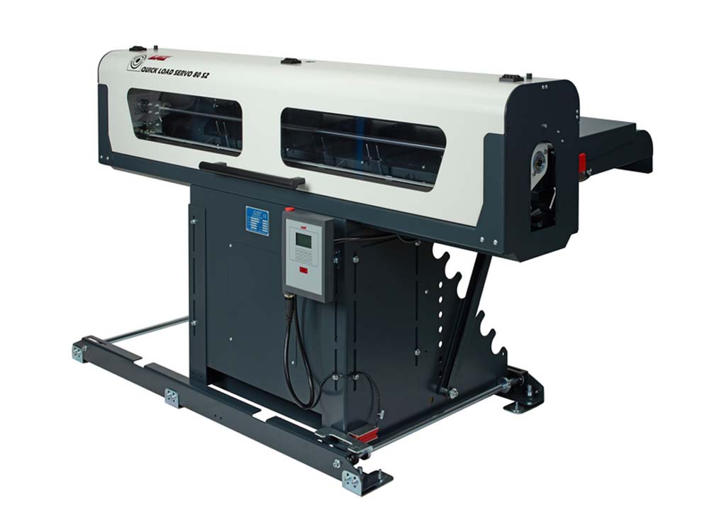

Bar Feeder
Bar Feeder
The LNS Quick Load Servo 80 S2 Bar Feeder allows for continuous machining with little or no operator intervention. With quick changeovers from one part run to another and a library of up to 500-part programs this servo driven bar feed will drastically increase productivity.
Equipped with an automatic diameter changing system, centerline and bar loading fingers adjust automatically as the new bar diameter is entered, no manual adjustment is required reducing changeover time to a minimum. The LNS servo motor control technology guarantees accurate bar feedout control with or without turret help and prevents hitting the turret with its soft touch positioning.

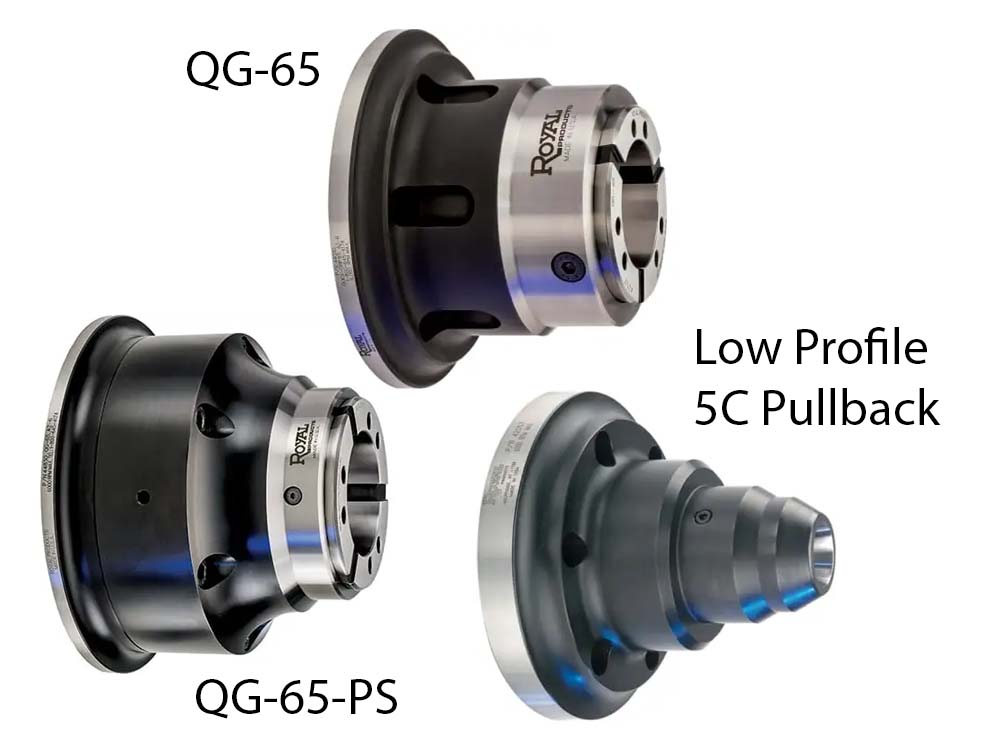

Collet Chucks
Collet Chucks
ROYAL QUICK-GRIP™ PULLBACK CNC COLLET CHUCK. Traditional pullback design utilizing Royal QG-65 collets allow for a bar capacity of 2.66” and runout on the closing angle within 0.0002" TIR.
ROYAL QUICK-GRIP™ PULL-TO-A-STOP CNC COLLET CHUCK. Adjustable stop guarantees precise, consistent z-axis part positioning and enables very aggressive cutting. Utilizing Royal QG-65 collets allow for a bar capacity of 2.66” and runout on the closing angle within 0.0002" TIR.
ROYAL LOW-PROFILE 5C PULLBACK CNC COLLET CHUCK. Traditional pullback design provides a simple, low-cost method for utilizing popular 5C collets, guaranteed to run within 0.0002″ TIR. Compact dimensions allow for superior tool clearance and Z-axis travel.

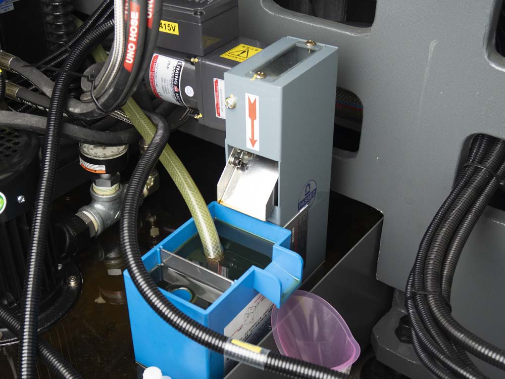

Oil Skimmer
Oil Skimmer
The TRAK Oil Skimmer is operated by a button on the control panel or may be integrated into your program with the use of M code.

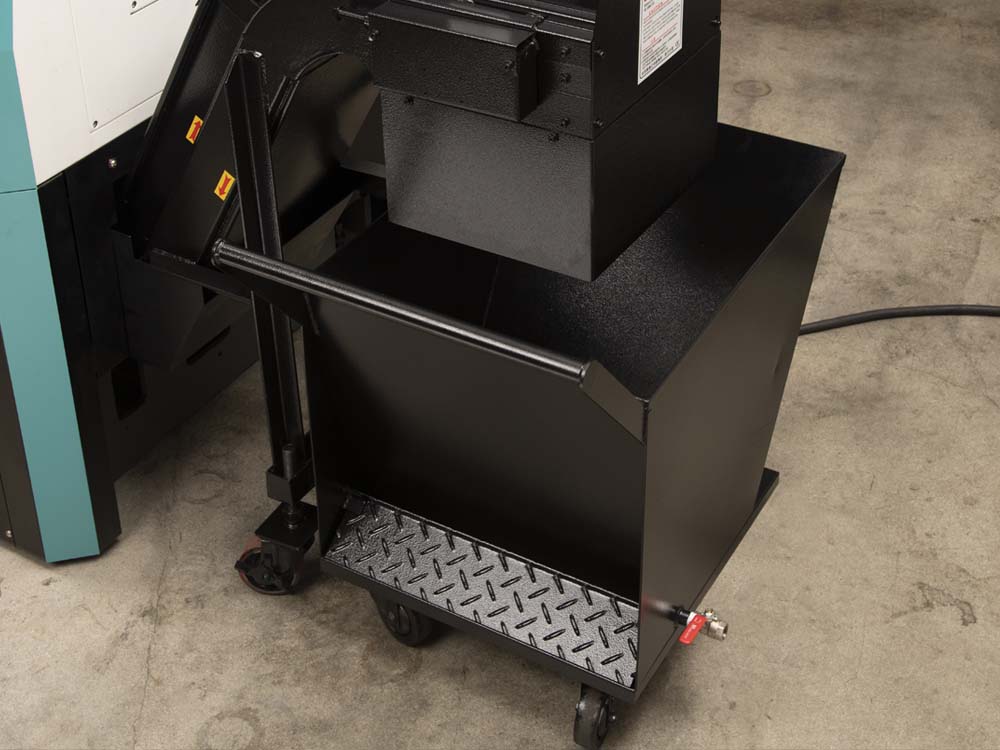

Chip Cart
Chip Cart
Chip cart that fits under the chip conveyor to collect chip remains. Wheels, coolant drain and dumping system for ease of use.

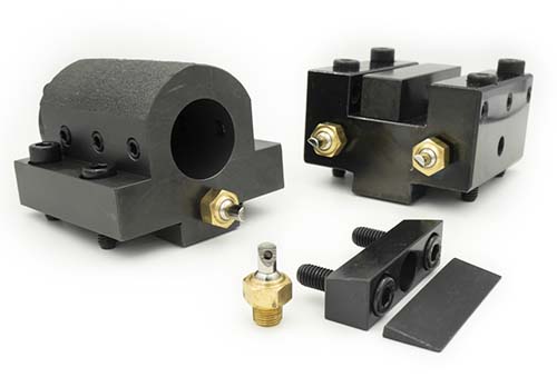

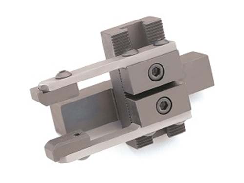

Toolholder Kit
Toolholder Kit
Bolt-On Toolholder Kit; includes 8 wedge clamps for 0.75″ tooling, 3 boring bar holders with 1.25″ bore, 1 slide tool holder and accompanying coolant fittings.

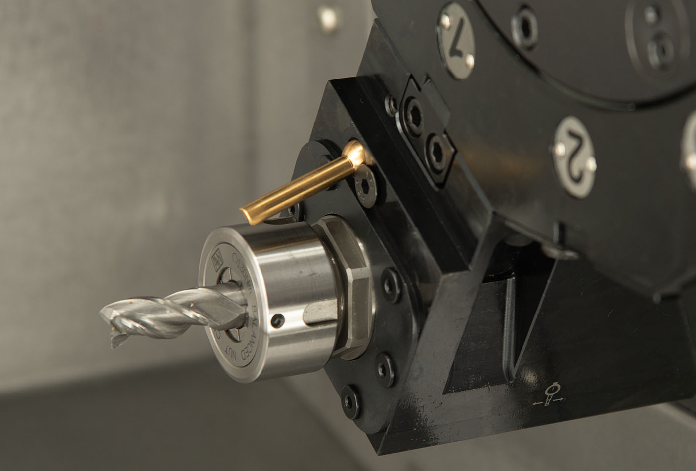

  • Half index tool holder kit
  • Live tool holders - ER20 and ER25

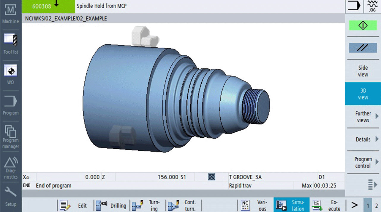

3D Simulation (P25)
3D Simulation (P25)
3D Solid digital twin of your part, faithful in every programmed detail. You can check your program by close inspection of each detail using the touchscreen operation of the 19″ screen of the SINUMERIK ONE.

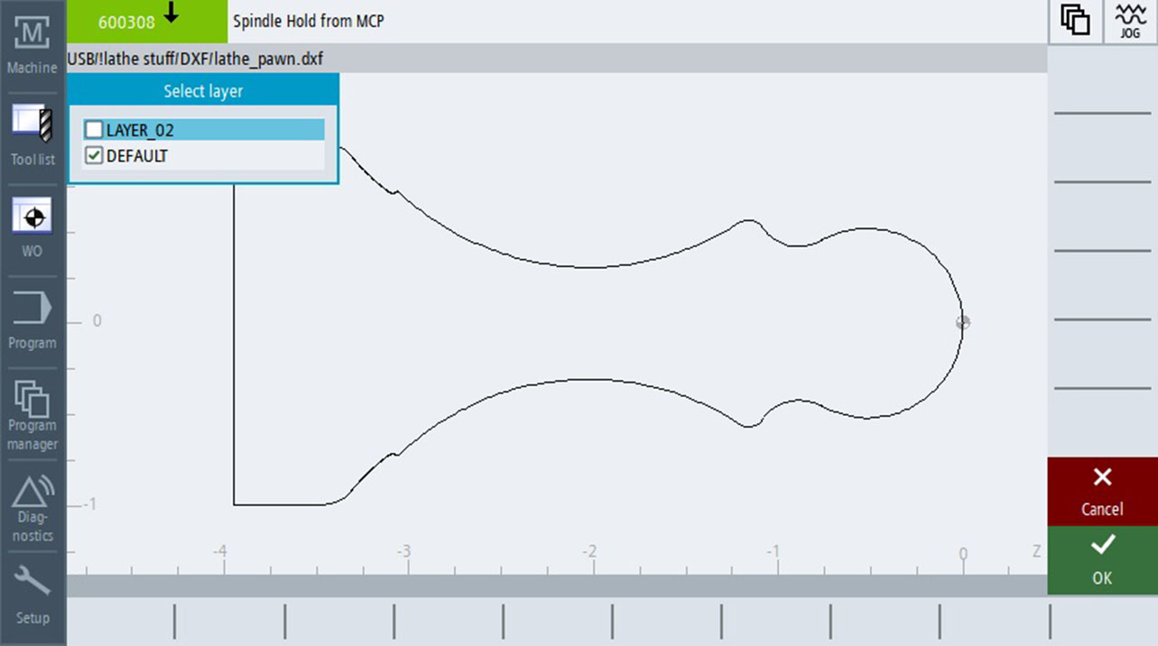

DXF Reader (P56)
DXF Reader (P56)
Open DXF files on the SINUMERIK ONE to easily transfer data into your program. Program faster and reduce errors on programming dimensions. Open and use elements of multiple DXF files in the same program. Works within all the programming methods. Easily command specific features from drawing elements. Set your own part reference independent of the drawing origin.

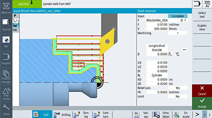

ShopTurn (P17)
ShopTurn (P17)

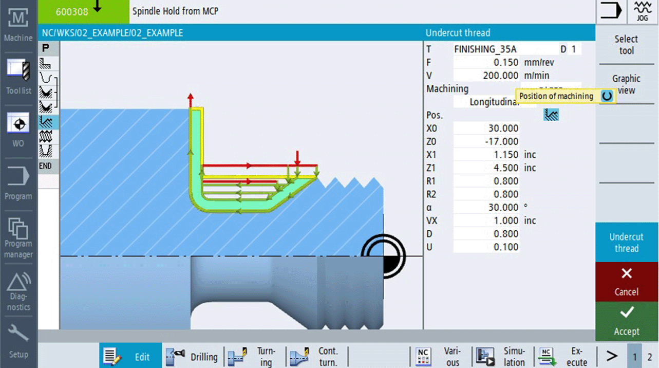

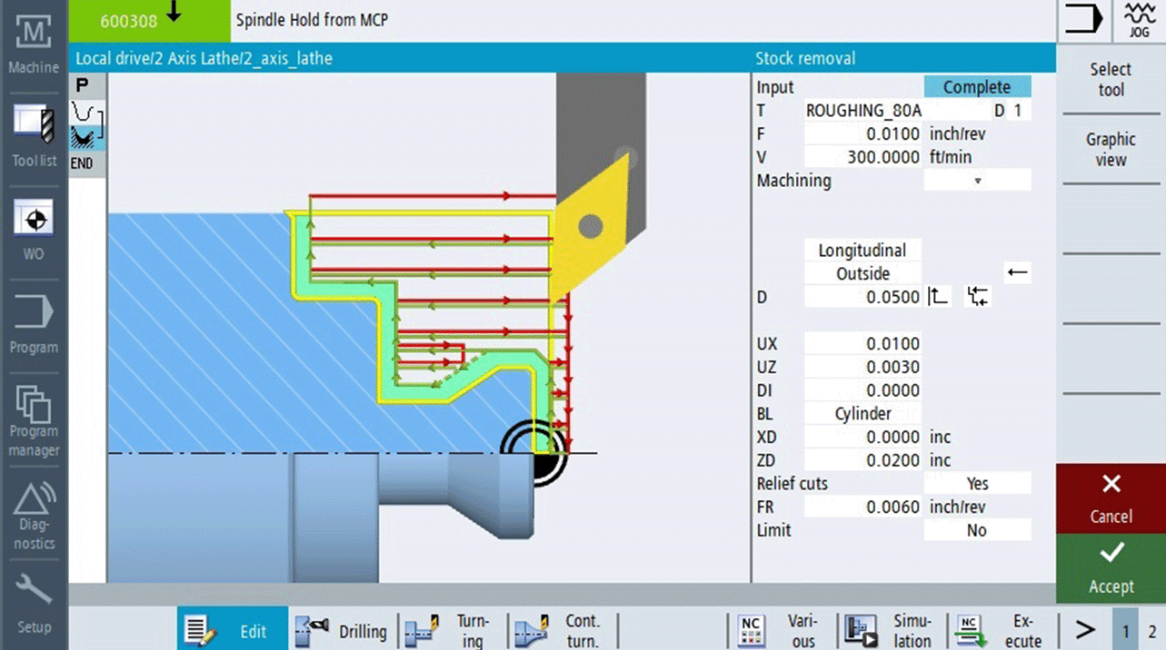

True conversational programming you can do right on the shop floor. Write complete part programs or insert a feature within another program. With guidance from Animated Elements, Tool Tips, Dynamic Graphics, Canned Cycles and Context-Sensitive Help to guide you can create programs with ease. You won’t have to go back to the person who programmed the part to fix or add to your program.

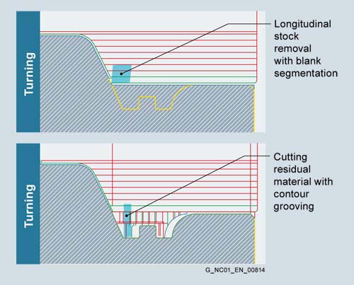

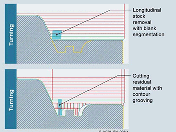

Residual Material Detection (P13)
The SINUMERIK ONE automatically recognizes Rest Machining situations. Simply call up the Residual Machining canned cycle, enter a few simple inputs and the control does the rest.
Match the tool to the operation for fastest machining: large tool for hogging, smaller tool for regions the large tool won’t reach. Multiple Residual Machining cycles in the same feature gives you the flexibility to minimize cycle times.

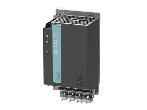

SINAMICS S120 Combi Drive
A power module with integrated infeed, motor modules for 4 axes (spindle and 3 feed axes). The combi drive has integrated external fans inside the heat sink installed on the back of the drive. It has an integrated brake control function for the motor holding brake and temperature sensor that activates an alarm if the temperature goes above the set threshold.

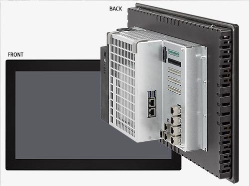

SINUMERIK ONE PPU 1740-1900
SINUMERIK ONE offers modularity, openness, flexibility and uniform structures for operation programing and visualization. It has integrated drive system SINAMICS S120 and S7-1500 PLC for medium and high-performance application. It offers high flexibility, excellent dynamics response, precision and optimum integration into networks.

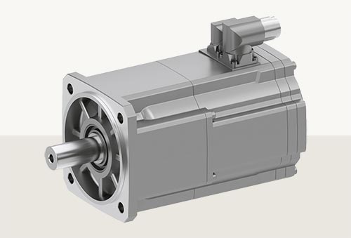

TRAK VMCsi Axis Motor
SIMOTICS S-1FK2 Axis Motor
SIMOTICS S-1FK2 are permanent magnet synchronous motors with high overload capability and integrated encoder system for speed and position control. It uses separate power and feedback cables to connect to SINAMICS S120 servo system. The motor has a 22-bit absolute encoder and connects to drive using the advanced DRIVE-CLIQ interface.

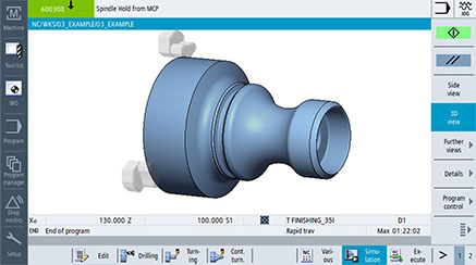

  • Touchscreen
    • 19” LED Multi-Touch Screen
    • Pan, zoom, pinch, rotate and scan, page up/down, swipe to top/bottom

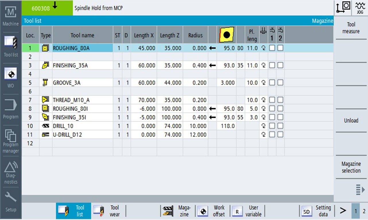

  • Tool names make it easy to recognize tools available and assign sister tools

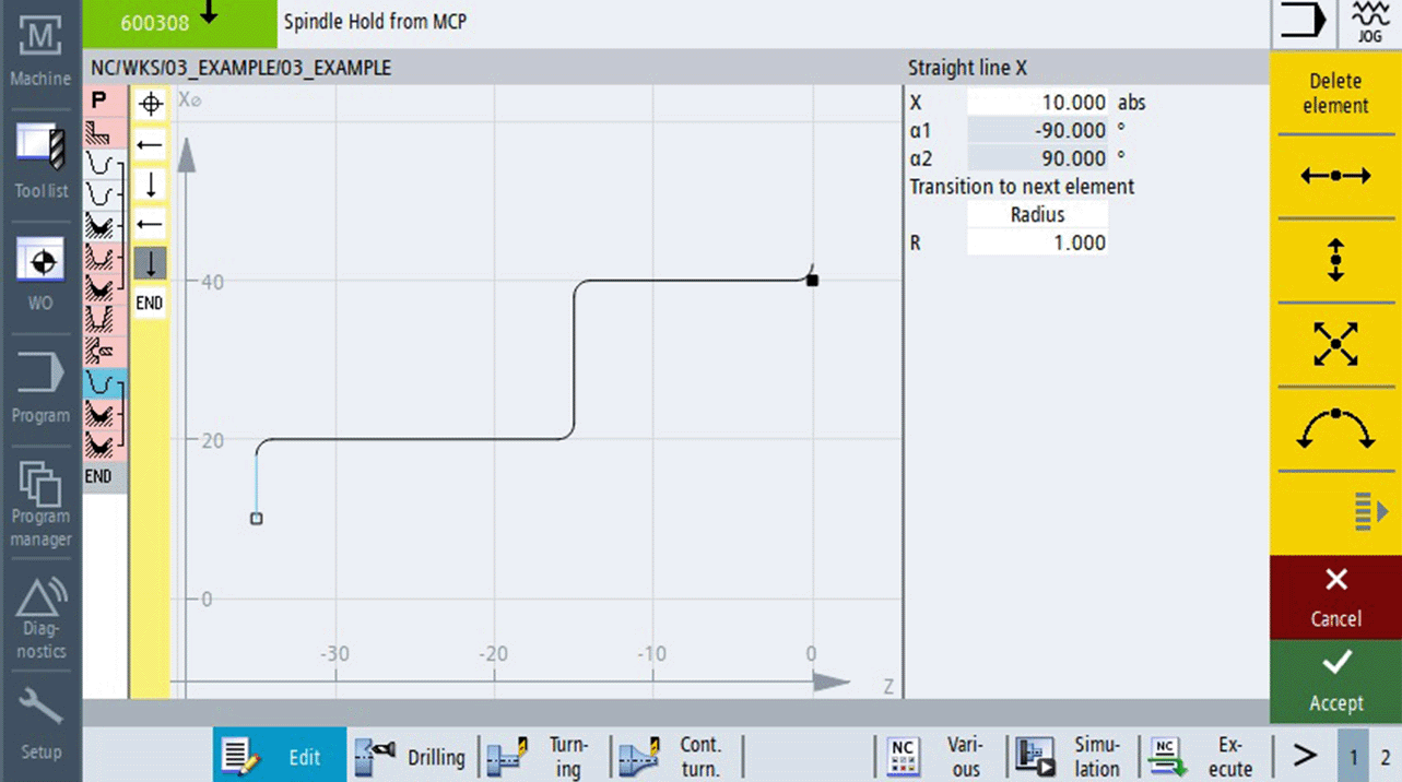

Contour Editor
This powerful tool works within the all the programming methods of the SINUMERIK ONE. Use graphical elements to create even complex shapes. Automatically calculates intersections and points of tangency.
Also use Contour Editor to work with elements in DXF files. Open the drawing data within the Contour Editor, then use define tool path and even edit the geometry.

  • Canned cycles make programming fill-in-the-blanks easy

Powerful Program Simulations
  • True representations of part and tool geometry.
  • 3D graphics with zoom and rotation of viewing angle. (O)
  • Controls for program speed, single block operation and stop/start.
  • Calculations for machining time.
  • Run simulations of different programs as a job is being run.

Tool Probing
Probing is integrated into the Jog Mode so you can set up tools easily and quickly.
Powerful DRO (manual mode) Routines
Part set up manual or with a probe.
Tool Setups
Setting tools is simple due to the icons and Animated Elements that guide your selections. You define number of flutes, tip angle, cutting edges, holder angle, tool type and even tool life. A Magazine view shows which tools are in the magazine.

DXF Reader (P56) (O)

Residual Material - Turning - SINUMERIK ONE
Residual Material Detection (P13) (O)
The SINUMERIK ONE automatically recognizes Rest Machining situations, simply call up the Residual Machining canned cycle, enter a few simple inputs and the control does the rest.

Simultaneous 3D Run (P22) (O)
3D Solid model graphics real time while running a program. It is a great way to check the progress of your job, especially when you are running a lot of coolant.
