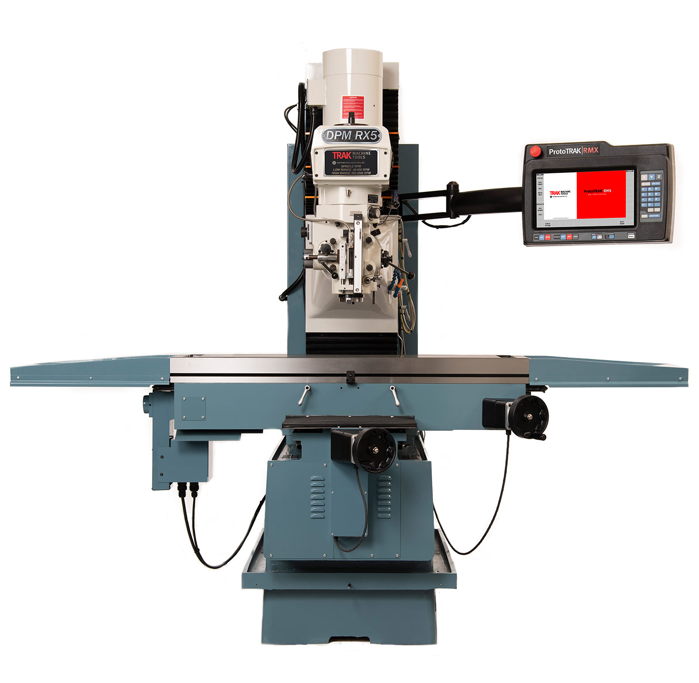

TRAK DPM RX5 Bed Mill Built for Large-Scale and Precision Milling
Specifications for the TRAK DPM RX5 Bed Mill
  • Table Size: 50″ x 12″
  • Travels: 40″ x 20″ x 25.81″
  • Spindle Motor: 5 HP Continuous
  • Spindle Taper: 40 Taper
Key Features of the TRAK DPM RX5 Bed Mill
  • ProtoTRAK RMX CNC integrated into the machine at the factory
  • Solid ram moves along the column providing mass for heavy cuts
  • Generous Z-axis CNC travel
  • Strong and rigid
  • Efficient for any job: manual, 2-axis CNC or 3-axis CNC
  • Standard electronic head for programmable spindle speeds and tapping
  • Precision ground ballscrews installed in the table, saddle and column
  • Manual quill with integrated quill and ram encoders
  • Wide way surfaces are hardened and ground, slideways are Turcite® coated
  • Real handwheels so you can work manually
