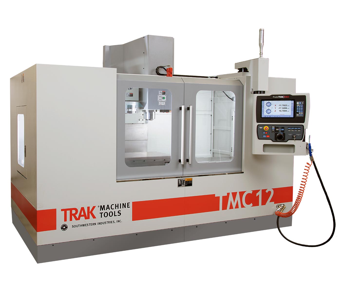

TRAK TMC12 Toolroom Machining Center featuring the ProtoTRAK RMX CNC
Specifications for the TRAK TMC12 Toolroom Machining Center
  • Table Size: 51.18″ x 23.62″
  • Travels: 50″ x 27″ x 25″
  • Footprint: 133.86″ x 144.76″
  • Horsepower: 22.5/15
Key Features of the TRAK TMC12 Toolroom Machining Center
Toolroom Ops - when you need the TMC to work like a TRAK bed mill, but with chips and coolant contained
  • Optional Electronic Handwheels (x, y, and z)
  • Selectable 2 or 3 axis CNC
  • Full DRO for manual operations
Production Ops - when you need to run small to medium production quantities
  • 16-tool carousel tool changer along with manual tool change for additional tools
  • Convenient Tool Table fly out window
  • Fully enclosed ANSI compliant operation
Specifications Compare TRAK Models
  TRAK TMC5 TRAK TMC7 TRAK TMC10 TRAK TMC12 TRAK TMC14
Table size 27.56″ x 15.75″ 35.43″ x 19.69″ 44.09″ x 19.69″ 51.18″ x 23.62″ 62.99″ x 23.62″
Travel (X, Y, Z axis) with soft limits 20″ x 16″ x 20″ 30″ x 20″ x 20″ 40.75″ x 20″ x 20″ 50″ x 27″ x 25″ 60″ x 27″ x 25″
Rapid traverse X, Y, Z 400 IPM in Toolroom Ops
1,000 IPM in Production Ops
T-slots (number x width x pitch) 3 x .709″ x 3.937″ 5 x .709″ x 3.937″ 5 x .709″ x 3.937″ 5 x .709″ x 3.937″ 5 x .709″ x 3.937″
Spindle taper 40 Taper 40 Taper 40 Taper 40 Taper 40 Taper
Spindle speed range 50 - 8,000 RPM
50 - 12,000 RPM (optional)
50 - 8,000 RPM
50 - 8,000 RPM
50 - 8,000 RPM
50 - 8,000 RPM
Spindle nose diameter 3″ 3″ 3″ 3.75″ 3.75″
Tool clamping force (90 psi) 1,500 lbs 1,500 lbs 1,500 lbs 2,200 lbs 2,200 lbs
Tool holder type CAT 40 or BT 40 CAT 40 or BT 40 CAT 40 or BT 40 CAT 40 or BT 40 CAT 40 or BT 40
ATC tool capacity 16 16 16 16 16
Maximum tool weight (incl. holder) 15 lbs 15 lbs 15 lbs 15 lbs 15 lbs
Maximum tool diameter 3.14″ 3.14″ 3.14″ 3.14″ 3.14″
Carousel speed .8 sec from station to station .8 sec from station to station .8 sec from station to station .8 sec from station to station .8 sec from station to station
Tool selection system Bi-directional/shortest path Bi-directional/shortest path Bi-directional/shortest path Bi-directional/shortest path Bi-directional/shortest path
Spindle motor HP - peak 15 HP 15 HP 15 HP 22.5 HP 22.5 HP
Spindle motor HP - continuous 10 HP 10 HP 10 HP 15 HP 15 HP
Power requirements
Standard (208V)
8K Spindle
208V (200-240V is acceptable), 3P, 68A
(Current can be as high as 87 amps with all options ordered - CTS (+14A), 4th axis (+5A))
208V (200-240V is acceptable), 3P, 93A
(Current can be as high as 112 amps with all options ordered - CTS (+14A), 4th axis (+5A))
Power requirements
Standard (208V)
12K Spindle
208V (200-240V is acceptable), 3P, 69A
(Current can be as high as 88 amps with all options ordered - CTS (+14A), 4th axis (+5A); includes cooler current)
208V (200-240V is acceptable), 3P, 96A
(Current can be as high as 115 amps with all options ordered - CTS (+14A), 4th axis (+5A); includes chiller current)
Power requirements
Optional (480V)
8K Spindle
480V with transformer option (432-528V is acceptable), 3P, 46A
46 amps based nominal rated current of transformer
480V with transformer option (432-528V is acceptable), 3P, 48A
(Current can be as high as 57 amps with all options ordered - CTS (+6A), 4th axis (+3A))
Power requirements
Optional (480V)
12K Spindle
480V with transformer option (432-528V is acceptable), 3P, 49A
(Current can be as high as 58 amps with all options ordered - CTS (+6A), 4th axis (+3A); includes chiller current)
Maximum weight of workpiece 880 lbs 1,320 lbs 1,760 lbs 2,200 lbs 2,640 lbs
Height of table from bottom of bed*** 38″ 38″ 38″ 38.37″ 38.37″
Min. spindle nose to table distance **** 3.5″ 3.5″ 3.5″ 2.25″ 2.25″
Max. spindle nose to table distance **** 23.50″ 23.50″ 23.50″ 28.75″ 28.75″
Distance of tool carousel to table 18″ 17.50″ 17.50″ 21.50″ 21.50″
Spindle center to spindle head casting face 16.50″ 18.25″ 18.25″ 27.56″ 27.56″
Min. machine height *** 90″ 90″ 90″ 105″ 105″
Max. machine height (head all the way up) *** 106.5″ 106.5″ 106.5″ 120.5″ 120.5″
Overall width of machine with side doors open, auger chute and chip container in place 159″ 167.25″ 174.50″ 206.27″ 224.13″
Overall length of machine with electrical cabinet fully open 180° 146″ 152″ 152″ 156.22″ 156.22″
Footprint of machine with coolant tank & auger in place and pendant rotated 90° (width x length) 92″ x 129.25″ 97″ x 135″ 111″ x 135″ 133.86″ x 144.76″ 157.48″ x 144.76″
Weight net / shipping (lbs) 7,260 / 7,600 8,360 / 8,700 9,900 / 10,300 14,300 / 15,000 16,500 / 17,000
Coolant capacity 56 gal 56 gal 56 gal 71 gal 71 gal
Coolant pump and wash power 750 Watt 750 Watt 750 Watt 750 Watt 750 Watt
Air - CFM (at 90 psi), SCFM 2.5 CFM, 18 SCFM 2.5 CFM, 18 SCFM 2.5 CFM, 18 SCFM 3.0 CFM, 25 SCFM 3.0 CFM, 25 SCFM
Air quality Air dried/water separator upstream of TMC Air dried/water separator upstream of TMC Air dried/water separator upstream of TMC Air dried/water separator upstream of TMC Air dried/water separator upstream of TMC
Lubrication pump capacity 2 liter 2 liter 2 liter 2 liter 2 liter
Specifications subject to change. *** Height changes slightly based on how machine is leveled on leveling screws. **** Can vary slightly due to home switch location and soft limit settings.

TRAK Toolroom Machining Center feat. the ProtoTRAK RMX CNC

Models
TRAK TMC5 Toolroom Machining Center Front View
  • Table Size: 27.56″ x 15.75″
  • Travels: 20″ x 16″ x 20″
  • Footprint: 85″ x 129.25″
  • Horsepower: 15/10
TRAK TMC7 Toolroom Machining Center Front View
  • Table Size: 35.43″ x 19.69″
  • Travels: 30″ x 20″ x 20″
  • Footprint: 97″ x 135″
  • Horsepower: 15/10
TRAK TMC10 Toolroom Machining Center Front View
  • Table Size: 44.09″ x 19.69″
  • Travels: 40.75″ x 20″ x 20″
  • Footprint: 111″ x 135″
  • Horsepower: 15/10
TRAK TMC14 Toolroom Machining Center Three Quarter View
  • Table Size: 62.99″ x 23.62″
  • Travels: 60″ x 27″ x 25″
  • Footprint: 60″ x 27″ x 25″
